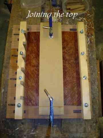

Here's my one hopfully, the sides can go at almost any angle so tapered boards can be joined, to took about hour and half to make and works very well, but I might change the middle hold down to a bar and wedges so I can see the join and wedge were most needed, although I haven't had any problems so far.

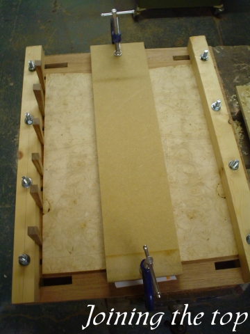

Here's another option:
tim...
